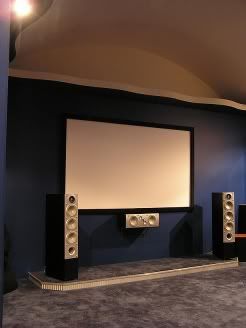

F6 UTE - Track Bound EVO III - Member 3,367 Member For: 20y 6m 1d Gender: Male Location: Strapped in and holding on Posted 07/11/05 03:34 AM Share Posted 07/11/05 03:34 AM I made my own. Cost me well under $100, and I had enough screen material left to make another.DON'T use malemine, the shiny paint will cause hot spots.Try not to flush Gyprock ( Plasterboard ) beacuse you will have edges unless you are as good as me.. J/K, nah, I did all my Ceilings as it was my trade.. Check out that light trough eh!! Seriously though, you won't get a good enough finish. The 'special' paint is good stuff, Screen Goo is sold by a few companies, But even the guy who sold me all my gear said how good my screen was and I didn't use any. Mine is Block out Cloth used for curtains, held taut by a flyscreen frame. Around it is Felt covered MDF skirting. Attached to the wall with big clips like what hold cupboard doors closed. 105" in total.Here is my HT thread..http://www.fordxr6turbo.com/forum/index.ph...topic=17248&hl=If you bring over some beers one night, I'll even show u it... Link to comment https://www.fordxr6turbo.com/forum/topic/21104-home-theater-screens/page/3/#findComment-312441 Share on other sites More sharing options...

Flukey Seriously Flukey Member Donating Members 4,354 Member For: 21y 2m 26d Gender: Male Location: Melbourne Posted 07/11/05 05:12 AM Share Posted 07/11/05 05:12 AM I made my own. Cost me well under $100, and I had enough screen material left to make another.DON'T use malemine, the shiny paint will cause hot spots.Try not to flush Gyprock ( Plasterboard ) beacuse you will have edges unless you are as good as me.. J/K, nah, I did all my Ceilings as it was my trade.. Check out that light trough eh!! Seriously though, you won't get a good enough finish. The 'special' paint is good stuff, Screen Goo is sold by a few companies, But even the guy who sold me all my gear said how good my screen was and I didn't use any. Mine is Block out Cloth used for curtains, held taut by a flyscreen frame. Around it is Felt covered MDF skirting. Attached to the wall with big clips like what hold cupboard doors closed. 105" in total.<div class='bbimg'></div>Here is my HT thread..http://www.fordxr6turbo.com/forum/index.ph...topic=17248&hl=If you bring over some beers one night, I'll even show u it... Sexy I'll sling you some beers in 10 months when the new place is finished. Link to comment https://www.fordxr6turbo.com/forum/topic/21104-home-theater-screens/page/3/#findComment-312471 Share on other sites More sharing options...
