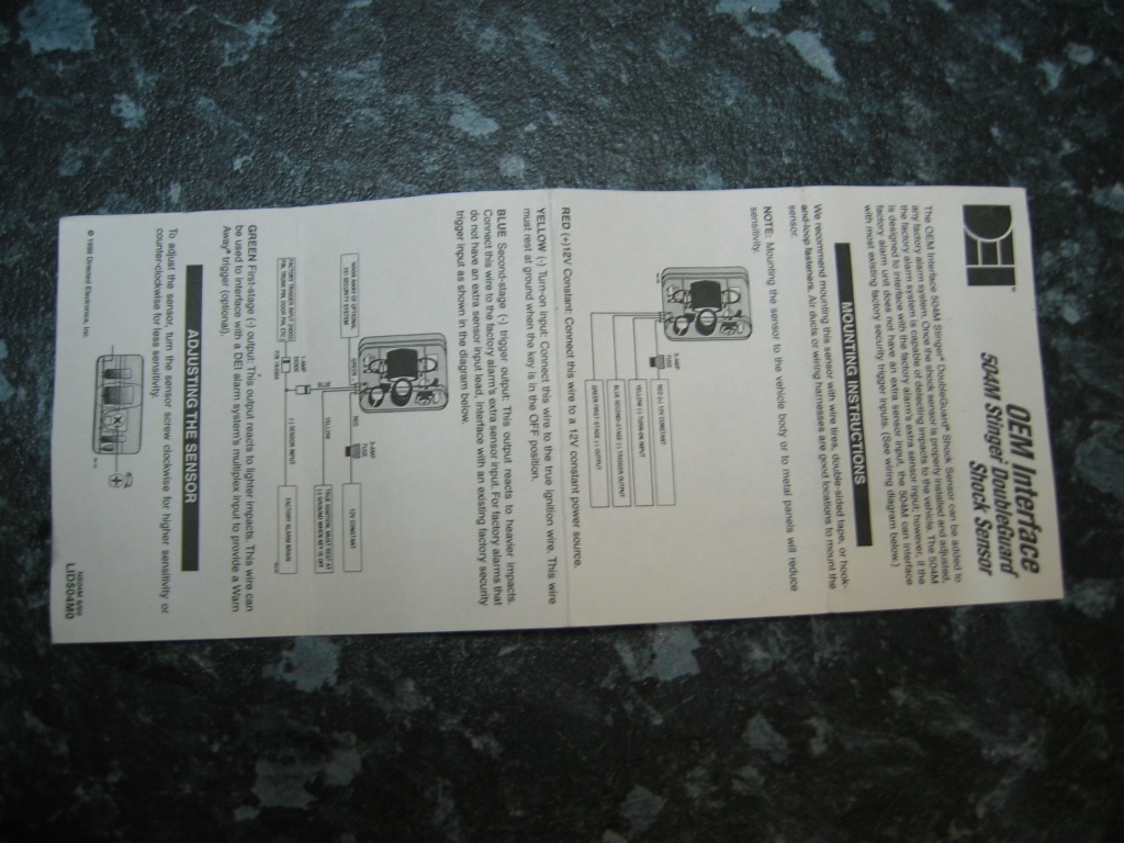

I added shock sensor to my standard factory alarm for that and fear of glass break entry. cost 50 bucks and just connects to the battery volts and bonnet trigger.
Do you have any photos of your install?
Where did you fit it etc?
Does it work well?
#9
1 It is quite sensitve but hasn't false triggered (also adjustable), gentle bear foot kick to a tyre trips it.
2 I installed it myself its in the engine bay tied to the wiring loom, however it gets very hot and I will move it when I work out somewhere better.
3 No pics its too dodgy!!...ok then but its only temporary remember.
#10
As I said its just temporary I want to put it near the BEM but I've got to have the ICC removed.
These are the specs on the sensor
