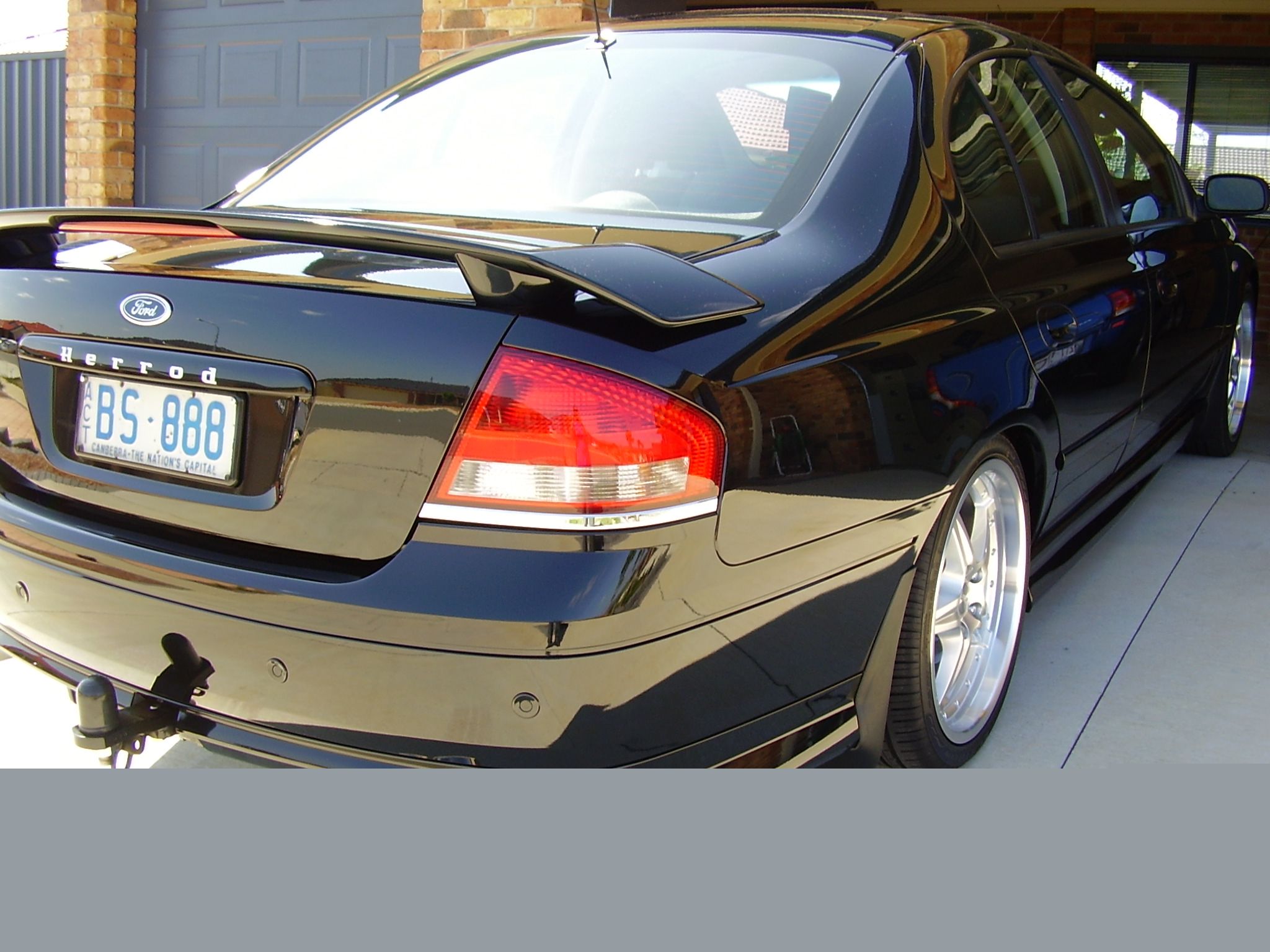

bs888 Member 207 Member For: 23y 9m 1d Location: Canberra Posted 09/02/05 09:48 AM Posted 09/02/05 09:48 AM Ok! just a quick description,After 400klm's my Herrod Quad system arrived, booked it in to be fitted only to be rung late in the day and told that I had to choose between the tow bar or the quad system as it wouldn't fit @#$&%^#@ I decided the tow bar was more important so they said they would fit a twin outlet system on that was in stock. (pic 1)It had a good sound, maybe a bit loud (but no worse than the dual system on the XR8 I had traded) and with just a little bit to much drone, but overall not to bad.wouldn't you know it!!! my next door neighbour comes home with a GTP fitted with QUADS!!! bye bye tow bar!!It's now a fair bit quieter with no drone at all and I think it looks fantastic! The sound is a lot deeper than the twin setup and it seems to have lost a bit of that 6 pot roar in favour of a nice sounding snarl at most rev's.
jetute Legacy Donating Member 4,553 Member For: 22y 7m 24d Gender: Male Location: brisbane Posted 09/02/05 09:53 AM Posted 09/02/05 09:53 AM nice info but the pic doesnt show the exhaust though
bs888 Member 207 Member For: 23y 9m 1d Location: Canberra Posted 09/02/05 09:57 AM Posted 09/02/05 09:57 AM have patience jet! I'm working on it!!!
bs888 Member 207 Member For: 23y 9m 1d Location: Canberra Posted 09/02/05 10:05 AM Posted 09/02/05 10:05 AM The end result!!sorry about the size of the pics but I have no idea about how to make them smaller!!there are more pics but if I put them on here I might have to answer to the "Mod's"
