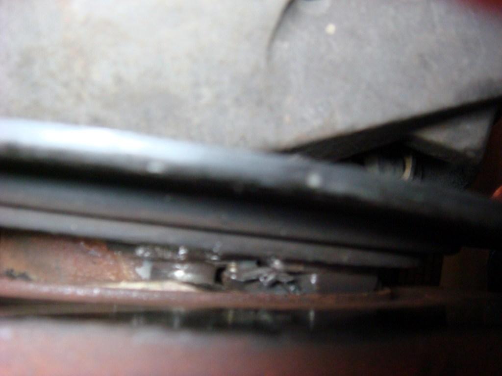

well, long story short, stuck hand brake + sledge hammer (not hammer, not mallet, but sledgey) = released hand brake. We managed to get the shoes free however the disc still wouldnt come off. It did however mean that we could put it back together and drive the car to Paul at Elite for its scheduled service. They confirmed that it was missing one of the main clips (the big dog leg one) and alowed the shoes to sit on an angle. This is not a nice fix by any rate, but when you gotta get it free. I tell ya what though, I was in the shed wheeling out the oxy when it come free.

so when I pull that rubber grommet off and look in the whole, I see a little gap in between what look like to half shoes. I assume these are the hbs? Do I need to split them further apart with a large screw driver and get mr mallet out? Thanks again for the replies.
cheers mate, have done that too, im thinking the only way to get this $#@%$ off is to bash it off like you say. Its the most stuck hbs I have ever seen.
Sooooo, disc is still stuck on. The hand brake shoes are stuck solid, solid to the point that attempting to leaver off the disk is actually pulling the brake shoe lining out. One other thing I did notice was there was quite a few raised edges on the front edges of the disc, suggesting the mob who did the hand brake shoes (hbs) had a lot of dramas getting it off, solving it with metal hammer. Is this going to be a case of oxy'ing the disc in half or maybe cutting the studs? Spoke to the boys where I was going to get a service, agreed that there aren't many options. Can I spray CRC or WD40 sorta stuff or is this a bad idea? Either way I am going to have to replace the disc after looking at what the last mob did. Any help would be much appreciated. Now where's the oxy bottles......
is there a way to manually release the hand brake shoes? the brake disc is completely release apart from the bottom....
partial update, it is the hand brake shoes stuck on. have the rear right wheel off, hand brake cable is loose, but the hand brake shoes are stuck hand up against the rotor on the inside. is there any secret to getting this off? or brute force required with a worse case of replacing the shoes again??
will go take a squiz now. cant really get to mechanic though if the wheels are locked? I assume giving it a boot to free it up will be a bad idea?
Hey guys, I have had the car sitting for about two weeks while I did a guage install (very slow one at that). All done, went to go put some fuel in, put it in drive, and no moving for me. It feels as though the hard brake is stuck on as the car sags in the ass while trying to move. If I increase rpm will move with an unfriendly squeeeel. Naturally I moved about 2 inchs and decided best not to proceed. Now I did have the crossover off to splice into the blow off vavle line for the boost guage. I have checked all the hoses I played with but they all seem fine. I checked the brake fluid resovoir and it looks quite low. If theres not enough fluid does it lock the brakes on? I would have though it the opposite. Any help would be much appreciated, I was going to fuel up tonight as I need to drop the car to Elite Auto tomorrow arvo for a service. Am I missing something? A hose? check the hand brake cable??? I did have new hand brake shoes installed about 1.5 months ago and have done very little driving since but none the less the hand brake wasn't stuck on then. thanks Josh P.S. Yes the hand brake is off.
