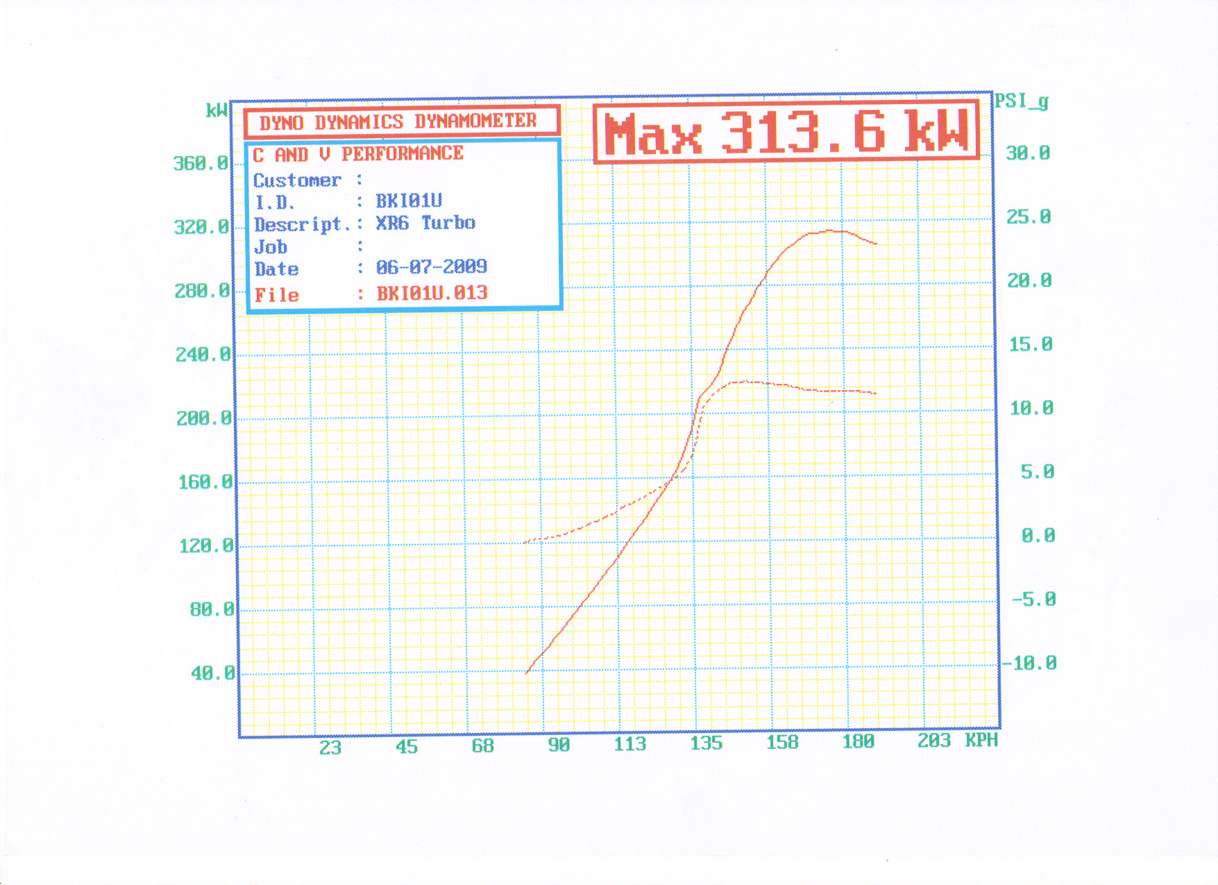

  2. The car had a custom flash (detonating it's head off) prior to this tune by a tuner who is not worth mentioning. Not one of our sponsors. The graph tells me the car is running about 13psi tappering back to about 12psi, however my guage inside the car says it's more like 14-15psi. It's only a cheap guage so it could be out by a pound or so. The car now pulls consistantly and smoothly. Breaks traction when the auto kicks down to second. The guys lifted the line pressure to the auto which has made cruising a little bit more aggresive in gear changes. But as I said to the guys at C&V, I prefer a hard changing box than no box. Firstly I want to install a nice cooloer for the trans. Then the valve springs because I think I have been very lucky to get this far, actuator and port the wastegate. Apart from the trans cooler the rest can all wait as I am extremely happy with the output I am getting. P.S I must add that I am extremely happy with the HDI Intercooler, power feels the same run after run! The stock intercooler after 2-3 runs felt like there was about a 15-20kw power drop. Thanks for your responses guys.
  3. Hey Guys, After sorting some boost leaks the BA went on to making 313.6kw atw with no sign of valve float from the stock springs! Stock actuator and wastegate prevented it from going any higher. BA 2005 MKII 4sp Auto HDI Intercooler with cold side piping 3" High flow cat with removed centre muffler and rear muffler Bosch 558 injectors and Walbro GSS341 Fuel Pump K&N Panel filter with APS under headlight CAI Custom tune by C&V Performance
