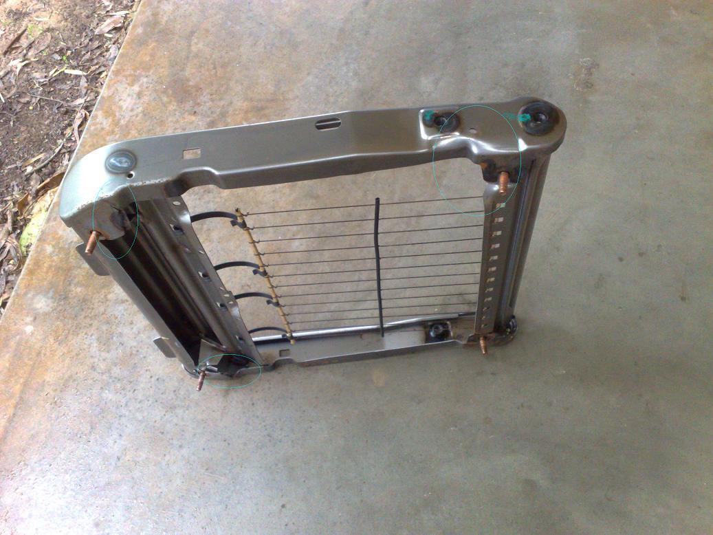

It must be a common problem if the wreckers are reinforcing them when welding them up, I was going to have a crack at it myself but it is very hard steel and trying to straighten it in a vice would probably cause metal fatigue and I'm not that flash at welding either and it's only $80, most other wreckers I phoned would only sell me a complete seat for $350.00. I was thinking of putting the seat cover in the washing machine, it is held on with gutsy velcro and is easy to remove but I think I will just give it a clean with a sponge, I'll give the washing machine a miss. -

I got it, pulled the seat out completely and dismantled it, it was a cracked and bent seat base, getting a change over one for $80.00 from my local ford wreckers here in Adelaide, the wreckers weld and reinforce the changeover replacement as well, thanks heaps for your input everyone -

I pulled the seat out and found no evidence of bent mounts, each mount (both frame to seat and frame to chassis mounts) appear identical to the passenger seat except for the seat height adjustment components. I have packed the seat up with a few washers (bearing in mind that the seat is an integral safety item in a crash) on the left side which has improved it somewhat, I only packed it up by about 5mm. It is a lot more comfortable now and the seat height adjustment moves silently and freely, whereas before it rubbed on the handbrake and centre console. It has me totally baffled, maybe the seat's internal foam has gone on one side, but that would only be evident when sitting on it, I am assuming that in it's past the car has had it's seat removed and an incorrect part fitted, it actually sits about 20mm lower on the left side, so something is wrong. -

Yes I do feel it, even more so now after seeing how crooked it is, I'll have to take the seat out and see what is going on. -
My driver's seat has always felt strange ever since I bought the car earlier this year, then a while ago I was sitting in the back seat and noticed that my driver's seat is tilted down on the left and almost touching the centre console, but the passenger seat appears more level, maybe the mounts are bent, I haven't had a chance to look at another XR6 to see if they are all like this, but I don't know why they would be though.
