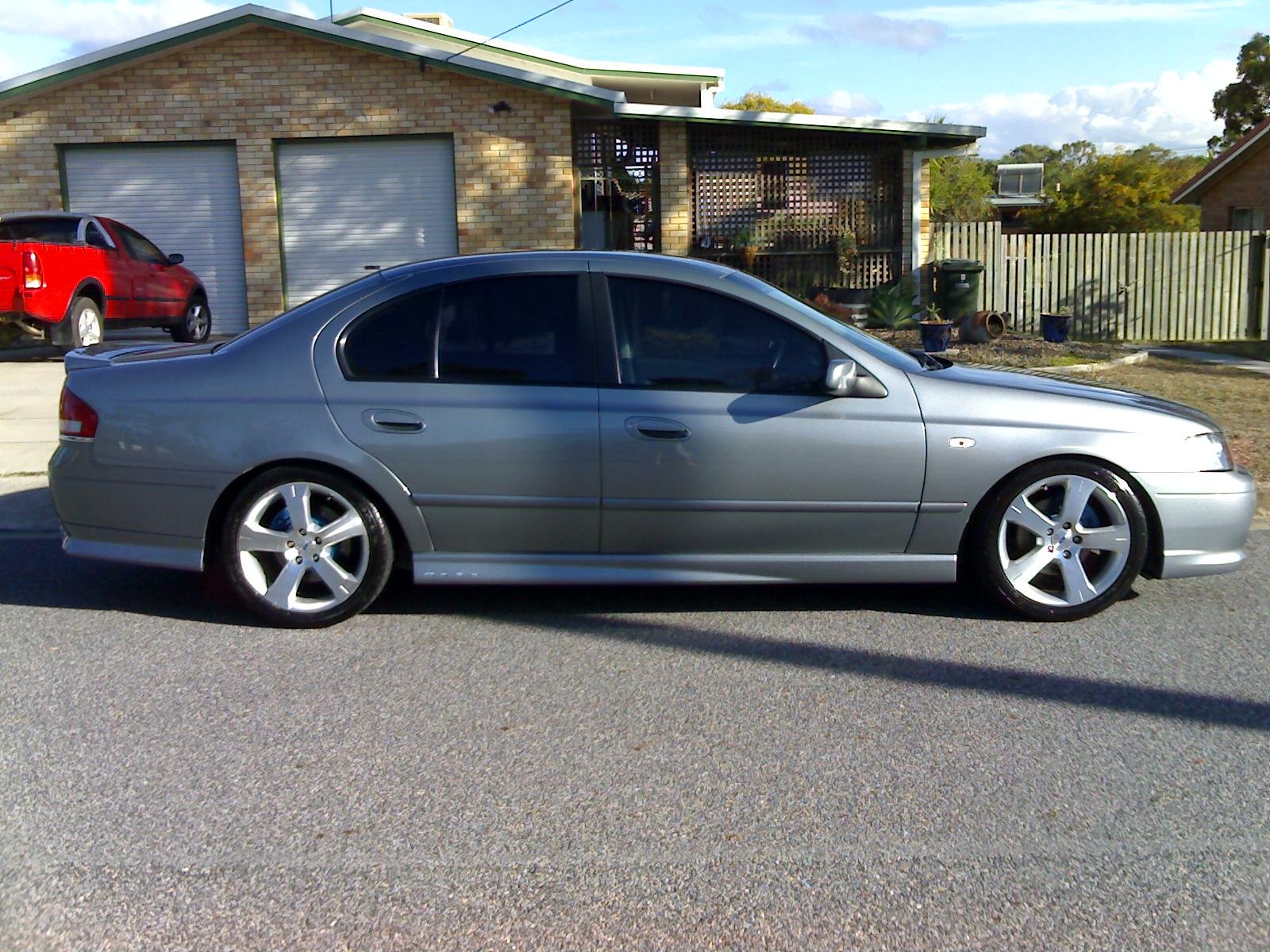

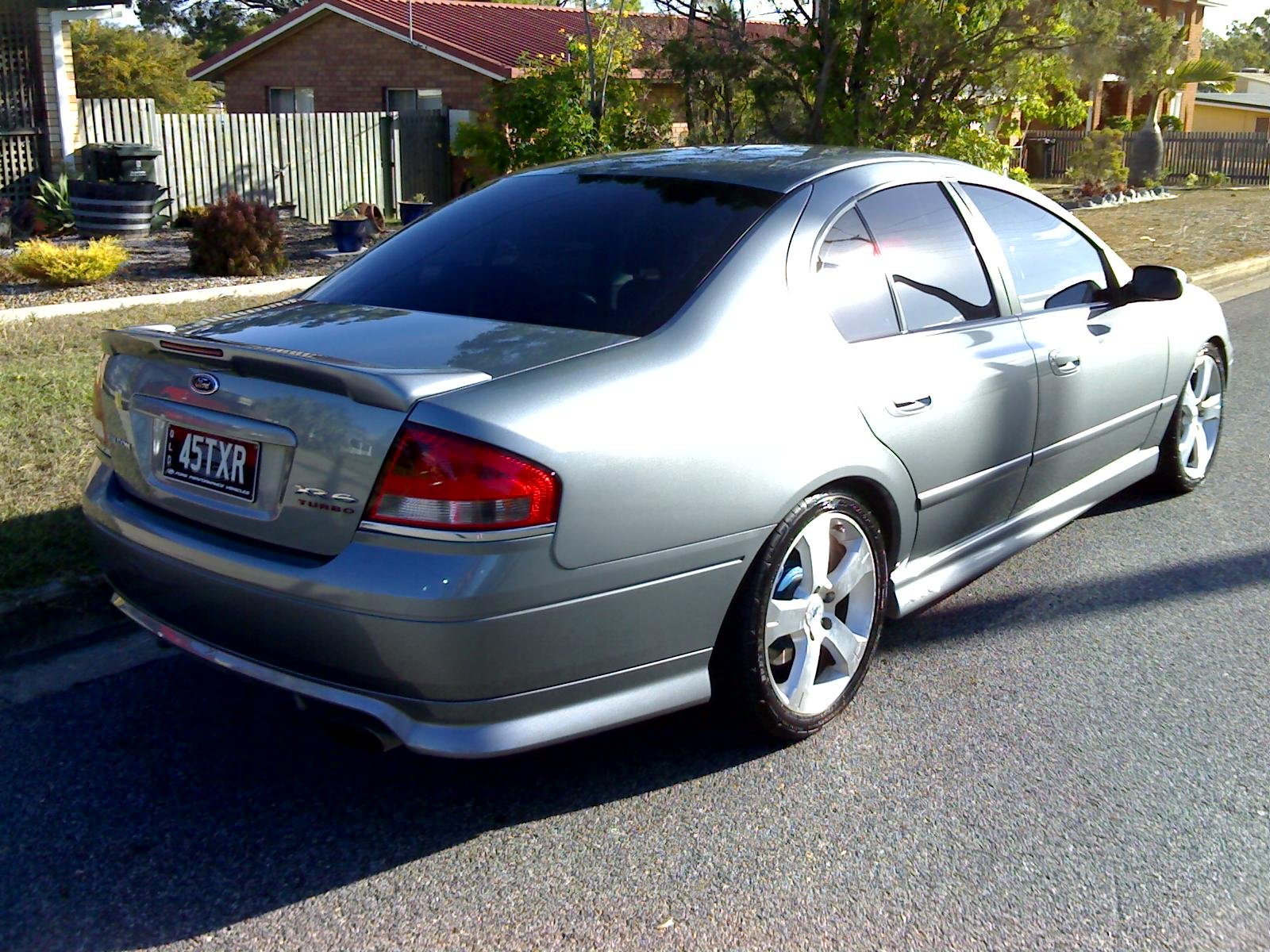

  1. Hahah, we have a few fords at home, the red rtv is my old mans, and his shopping trolley is a phantom purple 03 xr6 turbo. so between them and mine we have a few. Like I said previously, King springs, Au superlows in the fron and BA superlows in the rear Just went and measure dads and mine,, both with factor 18's. From the center of the rim to he guards, Standard Front: 360mm Rear: 360mm also Mine lowered Front: 330mm Rear: 333mm Handles extremely well and rides real nice. Just take one nob off the rear bump stops. (please not that a kidney belt is not required when carrying out this mod)

  5. To be honest, I cant remember how much ride height was reduced by. I will measure my old mans tomorrow and then mine and put up a post. I used Kings, AU superlows in the front and BA superlows in the rear, not sure what the difference is between the Au superlows and BA ones but Ive seen them used before and like how the car sat and handled. I chopped one nob of the rear bump stops, other then that it took just under and hour to do, considering up untill two days ago I was a mechanic at ford. cheers guys
  6. I think I've attatched the pics corretly......fingers crossed
