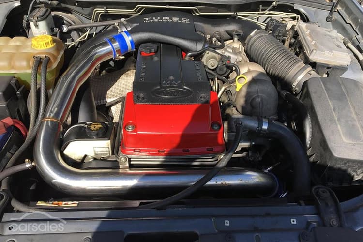

Grimdaddy New Member 4 Member For: 1y 10m 11d Posted 10/08/23 12:38 PM Share Posted 10/08/23 12:38 PM Hey guys I just has a question about installing a turbo side air intake was looking at getting an antz brand , with the battery relocation but it says it doesn't work with the factory intercooler pipping, what would I need to change to fix that ? Is there a kit that I can buy to change the pipe arrangement than to fit the turbo side air intake on cheers Would I also need a tune . Thanks I'm advance Link to comment https://www.fordxr6turbo.com/forum/topic/97033-2005-bf-xr6-turbo-falcon-turbo-side-air-intake/ Share on other sites More sharing options...
k31th less WHY; more WOT Site Developer 29,565 Member For: 17y 2m 12d Gender: Male Location: Melbourne Posted 10/08/23 11:14 PM Share Posted 10/08/23 11:14 PM Yes, you'll need a pipe kit also, as the OEM piping comes back underneath the battery tray and gets in the way of the intake piping that would come from the front of the turbocharger. So you'll need a piping kit that comes out the passenger side and then into the throttle body... the problem here is most battery-relocations also move the battery into the position the piping kits come out the passenger side, so usually you need one that comes back past the front of the engine to avoid it, like so (this has an intercooler with a passenger side exit as well, unlike the OEM intercooler): Or a custom piping kit that finds a way through and avoids the new intake/battery locations. Changing piping kits generally does not need a tune. But you might want one to make the most of the cooler air reaching the engine. Link to comment https://www.fordxr6turbo.com/forum/topic/97033-2005-bf-xr6-turbo-falcon-turbo-side-air-intake/#findComment-1719738 Share on other sites More sharing options...
Grimdaddy New Member 4 Member For: 1y 10m 11d Posted 11/08/23 03:42 AM Author Share Posted 11/08/23 03:42 AM Cheers for the info so would you know of a kit that would solve the issue for me or is it more of a diy cheers Link to comment https://www.fordxr6turbo.com/forum/topic/97033-2005-bf-xr6-turbo-falcon-turbo-side-air-intake/#findComment-1719740 Share on other sites More sharing options...
k31th less WHY; more WOT Site Developer 29,565 Member For: 17y 2m 12d Gender: Male Location: Melbourne Posted 11/08/23 06:33 AM Share Posted 11/08/23 06:33 AM You could contact Process West and ask them to separate out their cold side & a passenger-side-exiting intercooler (or you can buy an intercooler elsewhere) from the "stage 2.1 kit"... I don't know of anybody doing the piping like that anymore... Custom would probably end up cheaper/easier... Link to comment https://www.fordxr6turbo.com/forum/topic/97033-2005-bf-xr6-turbo-falcon-turbo-side-air-intake/#findComment-1719743 Share on other sites More sharing options...
