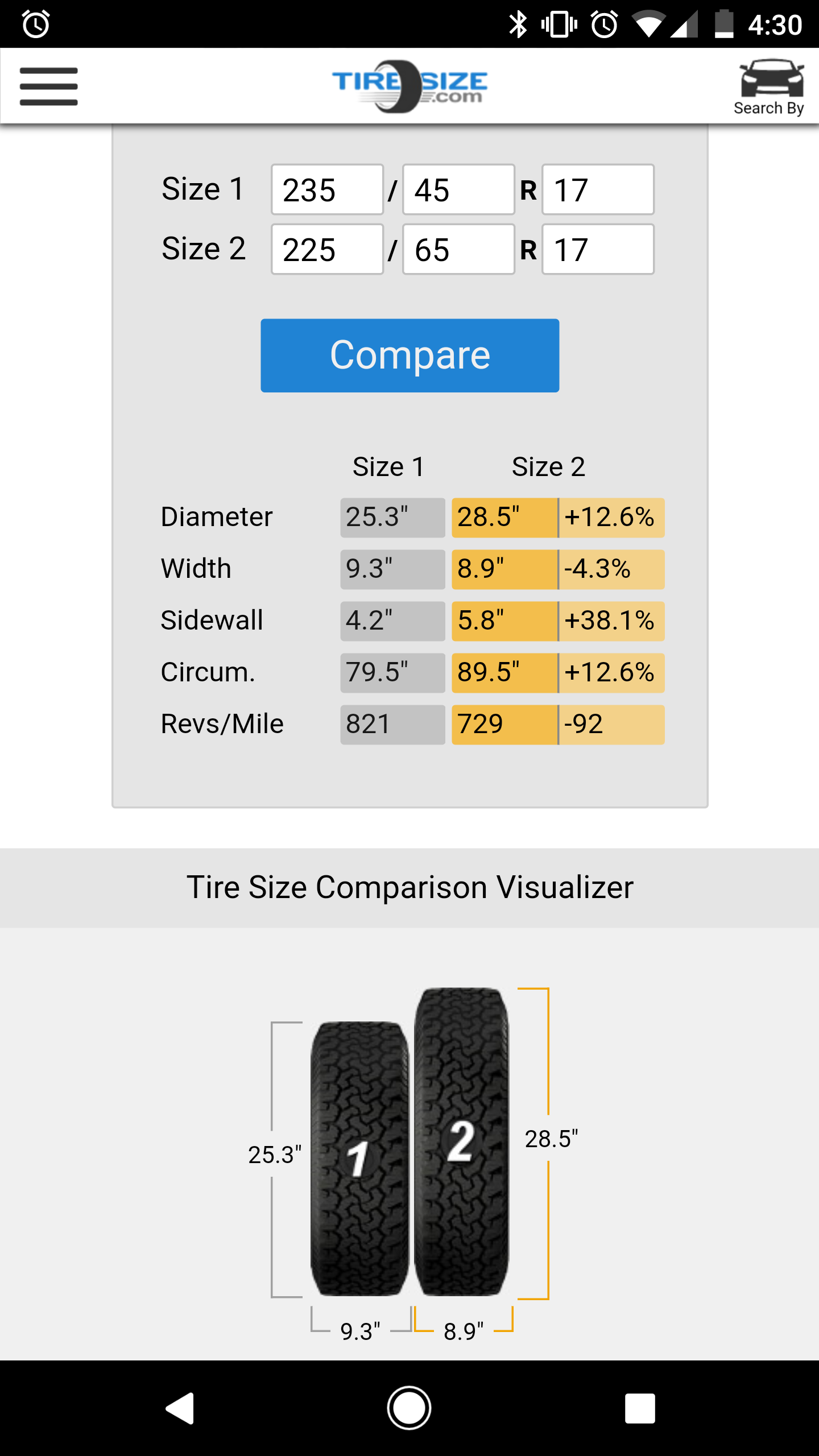

Wranglerfpr000 New Member 20 Member For: 7y 5m 26d Posted 12/02/17 11:02 PM Share Posted 12/02/17 11:02 PM Hey boys and girls, Got given a set of 225/65 R17 tyres with new new tread. Since im in search of what wheels I want to change to, I figured putting these on in the meantime as the current tyres are mcshagged till I work out what wheels to get. Now I sat the tyre next to wheels and looked fine as my coon is still standard grandpa height. So just clarifying if theres any tyre fitters on here, will they work in the meantime? Link to comment Share on other sites More sharing options...
Lunchietey Member 84 Member For: 13y 8m 24d Gender: Male Location: WA Posted 26/06/17 08:32 AM Share Posted 26/06/17 08:32 AM Will look f##king stupid if used in place of stock sized 235/45/17 Have a look at the comparison attached...(and yes I saw the date of this post but HAD to reply lol) Link to comment Share on other sites More sharing options...
