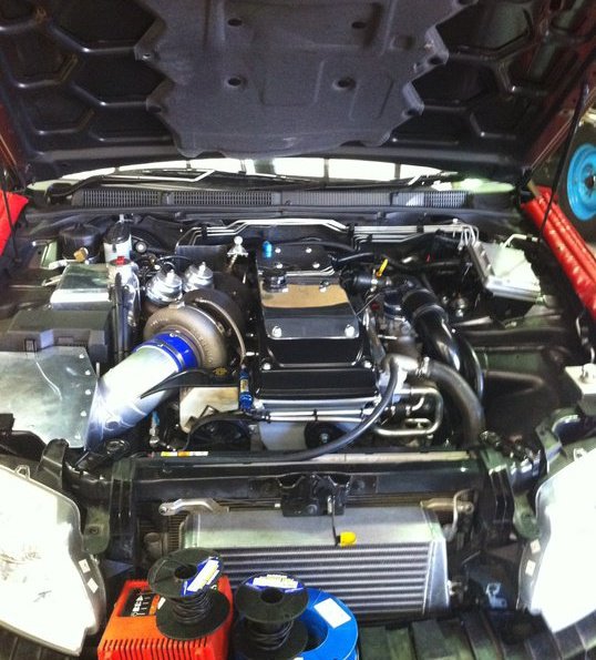

AtomiCg6 Legacy Donating Member 197 Member For: 15y 5m 18d Posted 25/09/11 10:42 PM Posted 25/09/11 10:42 PM (edited) His a pic of my engine bay, Gt42 twin gates, etm manifold, fitted pretty well, didnt have to move of customize anything I dont think..cheers johnny. Edited 25/09/11 10:45 PM by AtomiCg6
