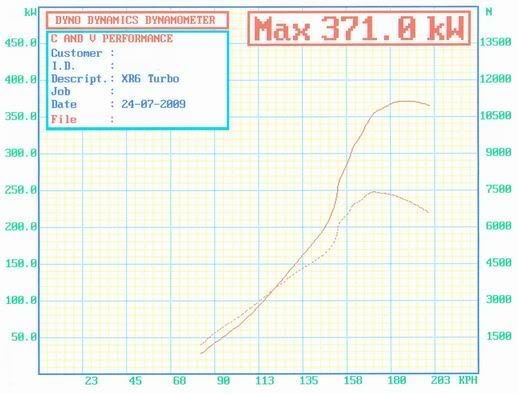

jescam Member 55 Member For: 20y 10m 20d Location: NSW Sth Coast Posted 24/07/09 07:27 AM Author Share Posted 24/07/09 07:27 AM Went up to C&V Performance today to check the tune on my XR6T, after I had the rear muffler removed.Tune was safe and power had increased to 371rwkw.With my stock bottom end, Con recommended to leave it at that!Guess the X-Force rear muffler I had on my car was cr@p, very restrictive!Again thanks to C&V for helping me out, also Kev for letting me get it done in worktime.......... thanks Boss Link to comment https://www.fordxr6turbo.com/forum/topic/59595-took-a-while-358rwkws/page/2/#findComment-911346 Share on other sites More sharing options...
