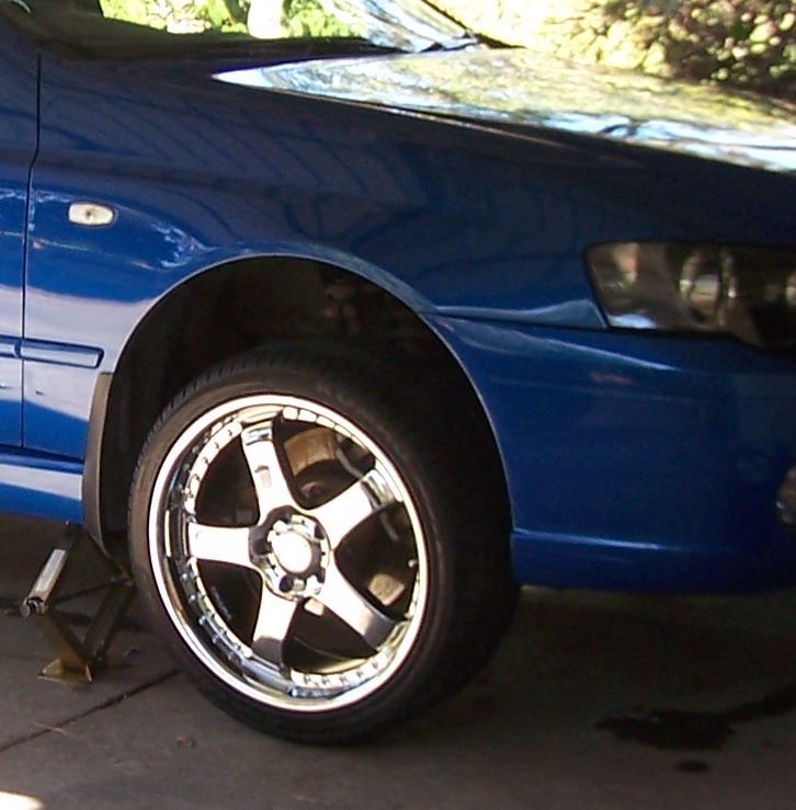

Coley Member 110 Member For: 17y 2m 15d Gender: Male Location: Ipswich Posted 20/07/08 04:50 AM Share Posted 20/07/08 04:50 AM My uncle is selling his car so the mags that were on it he was going to sell to me for my xr6t. They have been removed from an ss Late model camira that has a 5 stud pattern. When I went to fit them to my ute the holes didn't all line up. I thought this was strange so I went and got the old mags that were on my dads mitsubishi to see if they fit. They were also a five stud pattern and fitted straight on. Do Expensive Daewoo have a different stud spacing or would it just be the mags?These are the mags that wouldn't fit. The brand is AMG and they are 19" Link to comment https://www.fordxr6turbo.com/forum/topic/47792-5-stud-pattern-different-from-holden-but-same-as-mitsubishi/ Share on other sites More sharing options...
senna_T Forged Member Lifetime Members 15,818 Member For: 18y 5m 10d Gender: Male Location: SW Sydney Posted 20/07/08 04:54 AM Share Posted 20/07/08 04:54 AM Holdens have a different spacing mate, when I got my rims the supplier first sent the Expensive Daewoo stud pattern, had to send them back for the Ford ones Link to comment https://www.fordxr6turbo.com/forum/topic/47792-5-stud-pattern-different-from-holden-but-same-as-mitsubishi/#findComment-708060 Share on other sites More sharing options...

iTec TEAM BA Donating Members 1,755 Member For: 20y 7m 10d Gender: Male Location: North of The Bridge Posted 21/07/08 01:45 PM Share Posted 21/07/08 01:45 PM BA is 5 X 114.3Commy is 5 X 120 mitsubishi magna 5 x 114.3 5 x 114.3 is the most commonly used stud pattern in the 5 bolt configuration particularly with asian cars. 5 x 120 is more common on european cars but saying that there are countless combinations available Link to comment https://www.fordxr6turbo.com/forum/topic/47792-5-stud-pattern-different-from-holden-but-same-as-mitsubishi/#findComment-708790 Share on other sites More sharing options...
