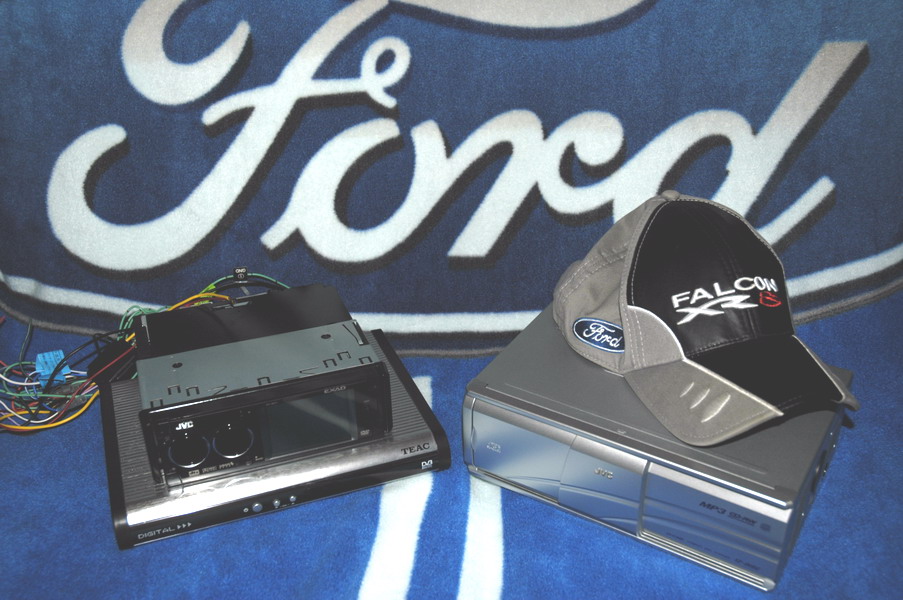

Don't know if the JVC will convert the STB signal, I would hazard a guess that it won't, but you may be lucky because this little DVD player from JVC is a beauty and has done everything I've needed it to do so far, no matter what I've thrown at it. I have the CH-X1500 mp3 12 stacker for it as well so I've got 18 discs (with the factory 6 in dash ) and mp3 on DVD as well as you said! Don't know what running out of music means anymore?!!
Yeh they are a pretty long unit and the stack of wires on the back does'nt help, but is'nt everything always squishy when it comes to putting something in a car?
Will post a pic or 2 when I get a chance to take a photo.
Here's a before of most of the gear.
