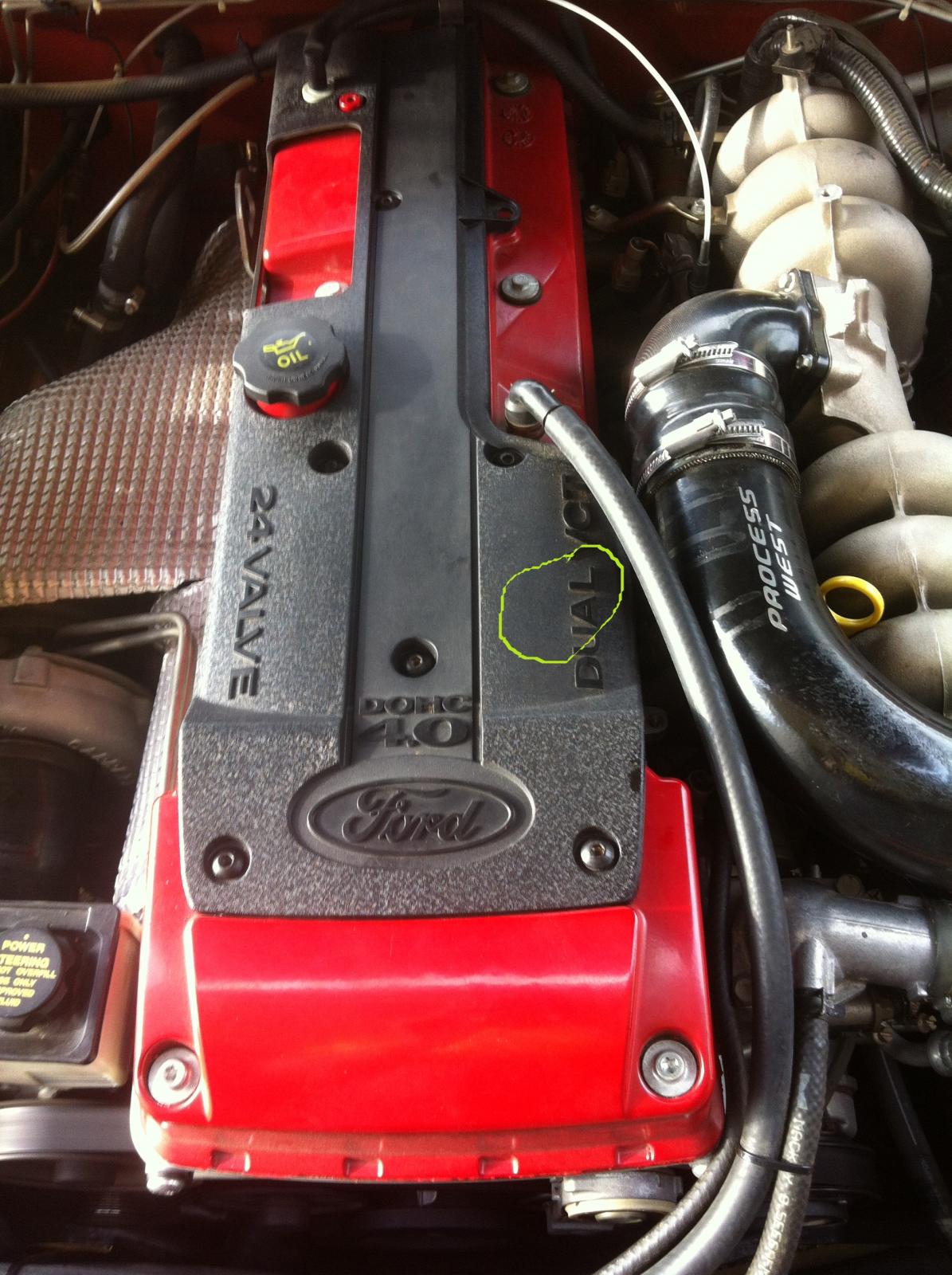

  16. I can only hear it right at the top of the head, no noise in the block. Only a very light knock, like a noisy tappet. You really think that could be a bent rod? even though my limiter is 5500RPM, and I never even hit that ?
  17. Done that. The circle is where the tap is coming from. I removed it and heard it with a tube to my ear. I only have insulated drivers.
  18. So, I'm sure some of you have seen my other thread about the possible VCT problem. Well I can hear and feel a tap in the head around the green circle area. It's not the injector of coil, I've already listened to them. I can feel a tap in the head, like a nosiy tappit... Under the black plastic, can't feel on the side of the head though, only on the top where the noise is coming from. What can this be ? Can this be the possible problem to my lost power ? Thanks.
