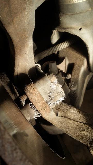

  2. hey guys my ba falcon has been pulling to the left (wheel alignment) out for the last 2 weeks now. tonight I started to get a really bad metal knocking sound when the weight is lifted off passanger side. especially when turning it gets really bad. pulled the left front tyre off and noticed the lower ball joint has been hit hard somehow (I havnt hit anything hard or whatever) and there is metal shavings all through the back of the disc etc where it is rubbing inside the rotors. Is this lower ball joint starting to fail??? any help would be appreciated thanks again guys. Please see the photos attached sorry for the poor dark conditions
  3. All fixed guys it was just the stabalizer bar nut that was loose. Had a look under and could see the chrome bit on other side of the nut and could undo it with my fingers all tight now and knocking gone.
