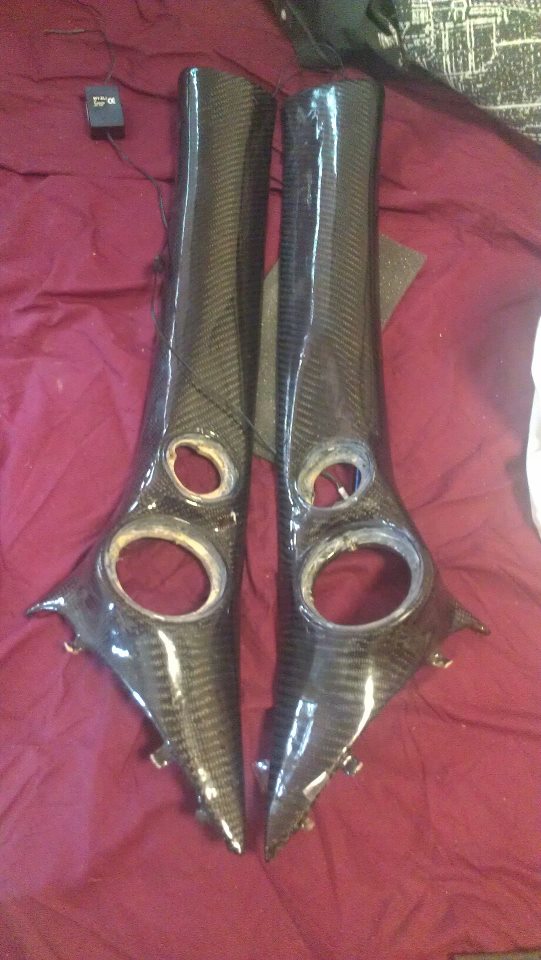

Where I am currently up to with the pillars pods just about ready for the speakers to go in this weekend
Sorry about the crap photos
