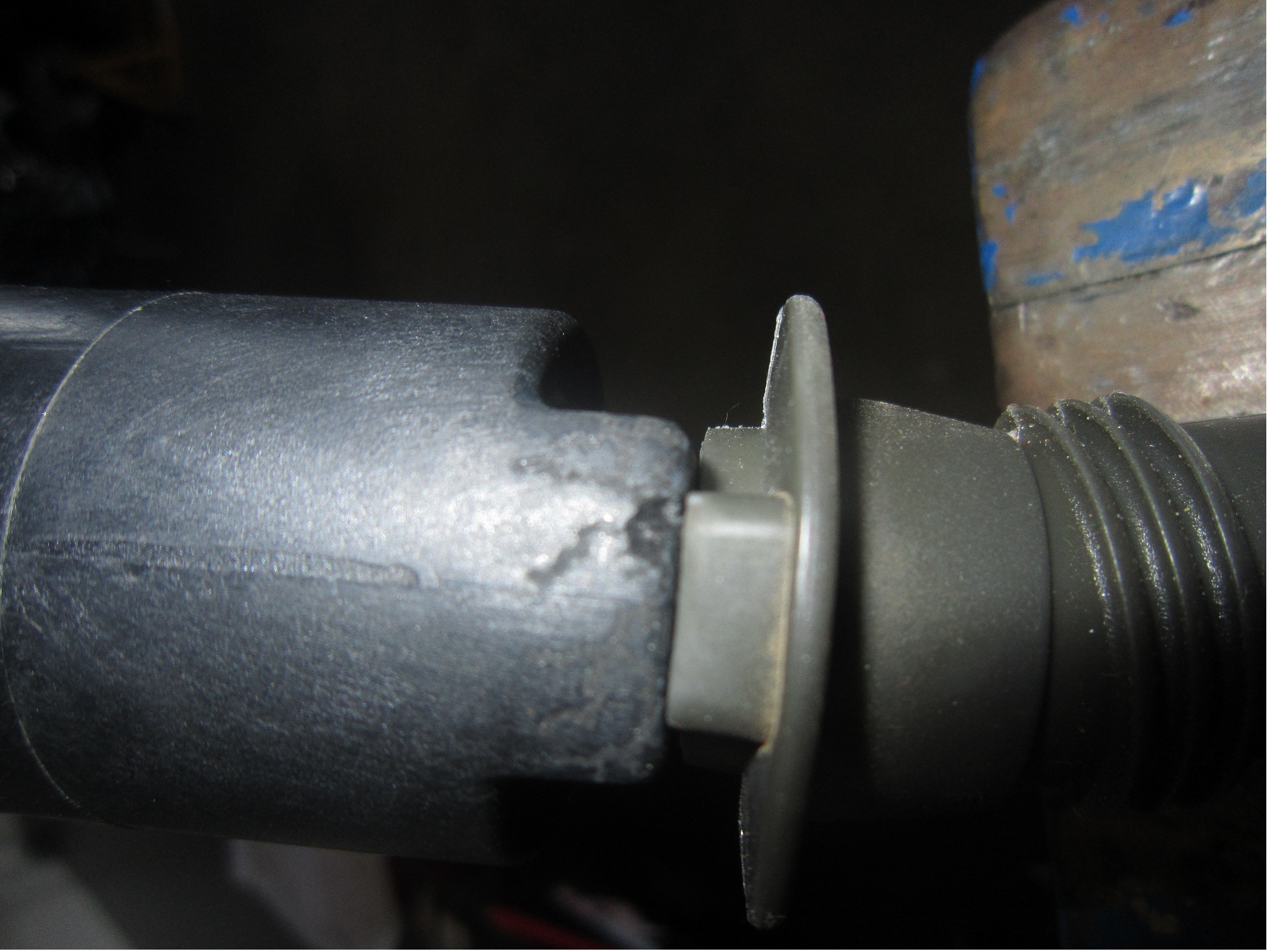

I changed the coils and all my problems went away.
here is a photo of what was wrong with the coil;
if u see anything like this on your coils replace them and u should be right.
good luck mate :buttrock:
