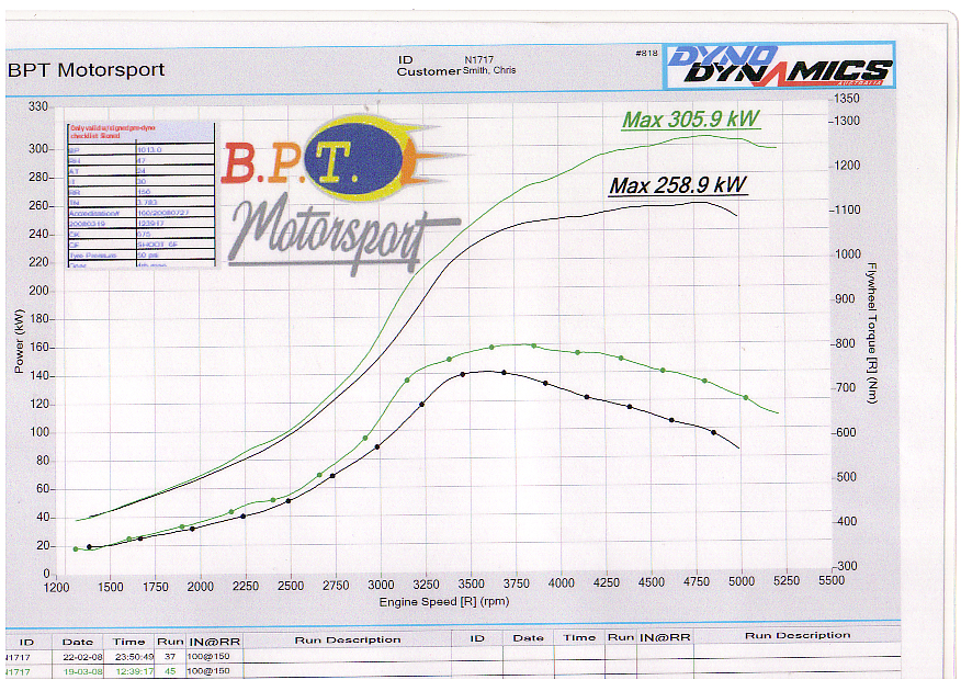

chrissat Member 12 Member For: 17y 5m 10d Posted 29/07/08 11:03 AM Share Posted 29/07/08 11:03 AM (edited) helloI just got around to posting my tune.chris Edited 29/07/08 09:56 PM by tab Link to comment https://www.fordxr6turbo.com/forum/topic/48142-3149-12psi/ Share on other sites More sharing options...
tevita6T Member 138 Member For: 17y 10m 8d Gender: Male Location: Brisbane Posted 30/07/08 01:24 AM Share Posted 30/07/08 01:24 AM Nice result! What mods have you done to reach that?? Link to comment https://www.fordxr6turbo.com/forum/topic/48142-3149-12psi/#findComment-712108 Share on other sites More sharing options...
chrissat Member 12 Member For: 17y 5m 10d Posted 30/07/08 05:48 AM Author Share Posted 30/07/08 05:48 AM Hellodirect plasmaman ic , injectors , pump , F6 ca . custom tuneim doing a rebuild atm for more power.oh and the clutchchris Link to comment https://www.fordxr6turbo.com/forum/topic/48142-3149-12psi/#findComment-712184 Share on other sites More sharing options...
PSYCHO XRT THE PSYCHO XRT Donating Members 1,275 Member For: 19y 5m 20d Gender: Not Telling Location: At the lights! Posted 30/07/08 06:35 AM Share Posted 30/07/08 06:35 AM Nice power mate. Link to comment https://www.fordxr6turbo.com/forum/topic/48142-3149-12psi/#findComment-712203 Share on other sites More sharing options...
EZ2CME Formerly XR6NA Member 3,512 Member For: 19y 5m 28d Gender: Male Location: Brisbane Posted 30/07/08 09:25 AM Share Posted 30/07/08 09:25 AM Congrats, enjoy the power. Link to comment https://www.fordxr6turbo.com/forum/topic/48142-3149-12psi/#findComment-712318 Share on other sites More sharing options...
chrissat Member 12 Member For: 17y 5m 10d Posted 30/07/08 12:01 PM Author Share Posted 30/07/08 12:01 PM HelloI have more comming . plasmaman 800hp ic kitmahle pistons , spool rods , nizpro springs ,pump gears ,4in dump 2.5in twin system ,mw tramp kit chris Link to comment https://www.fordxr6turbo.com/forum/topic/48142-3149-12psi/#findComment-712406 Share on other sites More sharing options...
IH8TOADS Silver Donating Members 3,618 Member For: 19y 10m 20d Gender: Male Location: OZ Posted 31/07/08 09:18 AM Share Posted 31/07/08 09:18 AM Nice power but it looks like a boring tune to drive IMO. The torque curve generally mirors the boost curve with these cars so I don't know why peak boost is after 4000rpm. You want it ramping on hard as. Much more fun to drive that way and ultimately much faster! I gather from the above that you mean you have not upgraded the clutch yet (makes sense why there's no boost down low)?? Also have you got any exhaust mods on this tune. You must have done the cat yeah? Link to comment https://www.fordxr6turbo.com/forum/topic/48142-3149-12psi/#findComment-712726 Share on other sites More sharing options...
DAVO61 Member 70 Member For: 20y 6m 11d Posted 31/07/08 11:18 AM Share Posted 31/07/08 11:18 AM looks good mate. won't be to hard on the car box and clutch will last a lot longer. Link to comment https://www.fordxr6turbo.com/forum/topic/48142-3149-12psi/#findComment-712791 Share on other sites More sharing options...
chrissat Member 12 Member For: 17y 5m 10d Posted 31/07/08 01:58 PM Author Share Posted 31/07/08 01:58 PM (edited) hellothat's my daily driver tune.my other tune just smokes thesh#t out of my tires and is very intresting in the wet.the clutch has be replaced with a mw opt3.was sick of slipping 3rd 4th 5th and 6th gear,with my other tune.chris Edited 31/07/08 02:02 PM by chrissat Link to comment https://www.fordxr6turbo.com/forum/topic/48142-3149-12psi/#findComment-712898 Share on other sites More sharing options...
