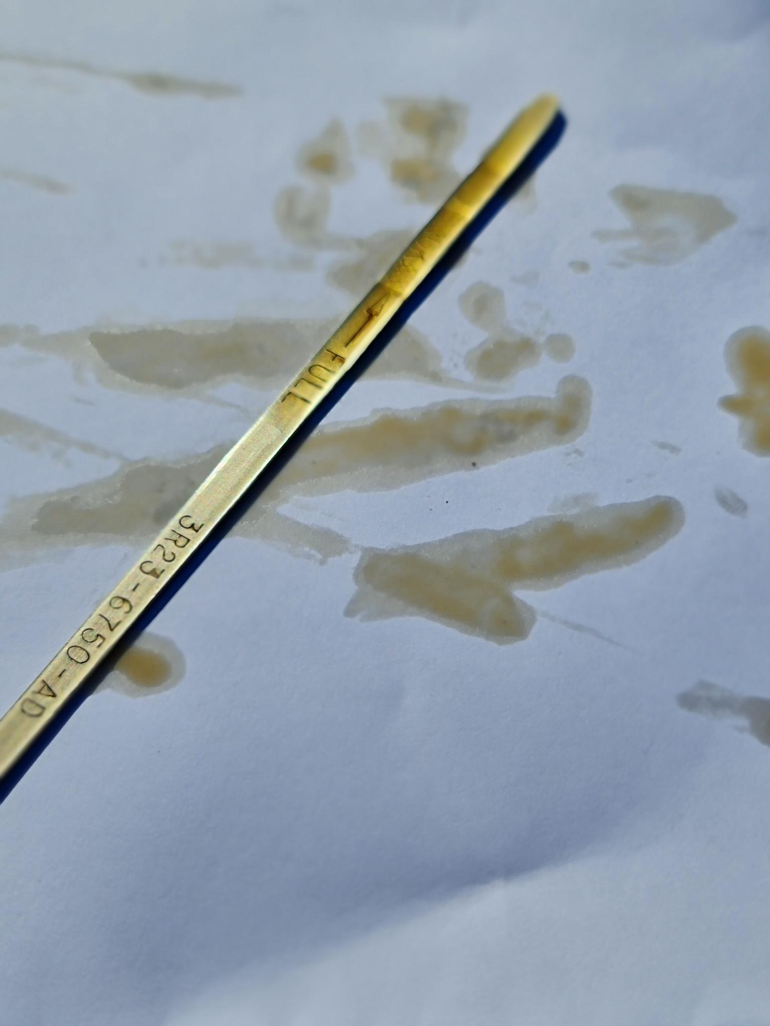

Jonno Member 79 Member For: 17y 8m 11d Posted 30/05/23 06:19 AM Share Posted 30/05/23 06:19 AM I have a series 1 BF XR6 Turbo with 202,000 kms that I have owned since new. It has the ZF 6 speed gearbox, which I have had serviced about every 50,000 kms. I had a general service done last week that cleared up oil leaks from the rocker cover and power steering pump and high-pressure hose. After that the engine was steam cleaned. As part of that service the transmission fluid level was checked and topped up with a litre of ZF Lifeguard. After parking the car in my driveway, I noticed a remaining oil leak. When I returned to the mechanic, I found that bottom front of the transmission was covered in oil (see attached image). The leaking oil is darker than the engine oil which was changed at the service (see attached image). My impression from driving the car is that the transmission is working as it always has. No hesitation, slipping etc. Any ideas? Link to comment Share on other sites More sharing options...
Puffwagon Puff Gold Donating Members 15,117 Member For: 9y 2m 21d Gender: Male Location: South Australia Posted 30/05/23 06:56 AM Share Posted 30/05/23 06:56 AM My first thought is that the rocker cover was leaking oil into the bellhousing and residual oil is leaking out. If they have used a bunch of degreaser around the area after fixing the rocker cover leak, it may have also got in there, freeing up the mess inside even further. Finally the steam clean may have also leaked into the bellhousing adding to the mix. Get a mirror on a stick to have a look behind the rocker cover, it'll at least let you know if it's leaking from there still. Link to comment Share on other sites More sharing options...
k31th less WHY; more WOT Site Developer 28,292 Member For: 16y 9d Gender: Male Location: Melbourne Posted 30/05/23 07:03 AM Share Posted 30/05/23 07:03 AM Could also be the rear main seal leaking from there... but that's unlikely if it's gearbox oil, of course... could also be a tiny leak in the converter or the seal around the input shaft/converter area... but you'd think you'd notice different driving characteristics for something like those gearbox leaks Link to comment Share on other sites More sharing options...

Slash737 Member 107 Member For: 19y 1m 24d Gender: Male Location: western melbourne Posted 30/05/23 12:52 PM Share Posted 30/05/23 12:52 PM My bf2 turbo was leaking like that. Had the rear main seal changed, still leaking. Turns out it was the sump leaking. Had it re sealed and it hasn't leaked since. Link to comment Share on other sites More sharing options...

Puffwagon Puff Gold Donating Members 15,117 Member For: 9y 2m 21d Gender: Male Location: South Australia Posted 31/05/23 02:24 AM Share Posted 31/05/23 02:24 AM They would be giving you a range of possible causes and fixes which is not any better than what we're doing here, except they usually know what they're on about. If it isn't coming from the rocker cover still, the sump gasket or a crack in the sump, anywhere else you can see such as turbo drain etc, or just residual, you have to pull the box out for a look. You have to pull the box to check the rear main obviously. I would get under there clean the living fark out of it (perfectly clean) and have a damn good look for cracks in the sump or other possible leaking areas. After the clean and inspection, go for a short drive and have another look under there. This should show up whether it's leaking past anything external that you can see. A free way to check if it's residual is to clean it daily and see what it drops overnight. If it is residual it will eventually stop coming out. If it keeps leaking it's time to look further. Reconditioning the box is not the appropriate fix for an oil leak. Would you recon an engine because it has an oil leak? You aren't reporting a trans issue, you're reporting an oil leak. It's leaking from somewhere and that somewhere needs to be found with 100% certainty before a fix is implemented. Link to comment Share on other sites More sharing options...
