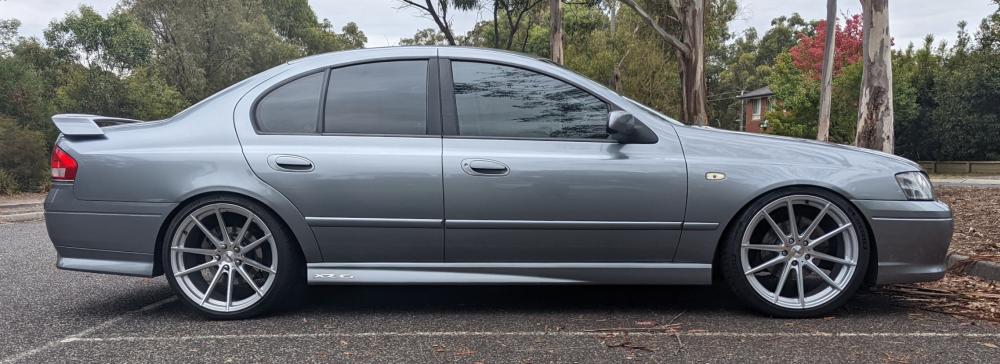

k31th less WHY; more WOT Site Developer 29,549 Member For: 17y 2m 5d Gender: Male Location: Melbourne Posted 12/01/23 10:07 AM Author Share Posted 12/01/23 10:07 AM Here's some pics @Typhoon has given me the OK to post... You can see the front-side of the caliper is "slimline" compared to the back-side, so this will be the caliper that's slimmer. This looks like the 372mm rotor... (Typhoon can clarify if this isn't the 372) And as Typhoon said, the 343mm fits inside the factory 17's... nice. 3 Link to comment https://www.fordxr6turbo.com/forum/topic/96882-vari-brakes-kits/page/3/#findComment-1716665 Share on other sites More sharing options...
