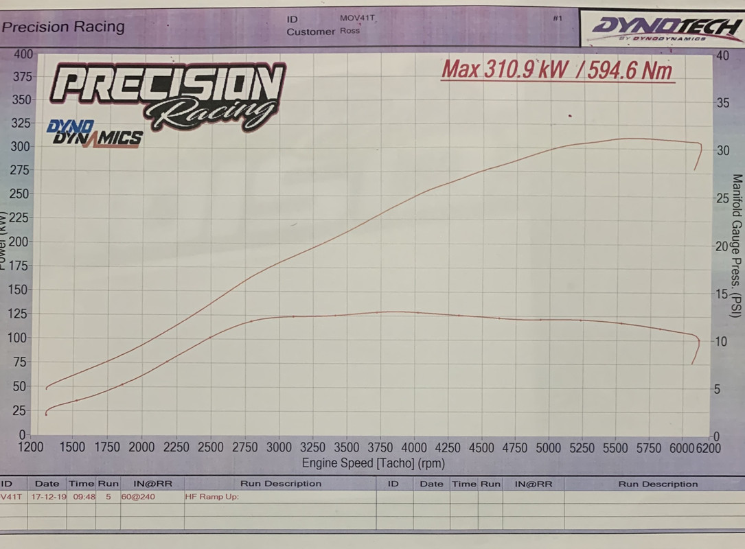

gaz097 Bronze Donating Members 1,751 Member For: 12y 8m 28d Posted 29/01/20 09:28 AM Share Posted 29/01/20 09:28 AM 98? If so looks about right. Need bigger turbo Link to comment Share on other sites More sharing options...
k31th less WHY; more WOT Site Developer 28,291 Member For: 16y 8d Gender: Male Location: Melbourne Posted 29/01/20 11:06 AM Share Posted 29/01/20 11:06 AM Good job, @GAS41T Looks like you're onto a good tune. Link to comment Share on other sites More sharing options...
GAS41T Member 39 Member For: 8y 7m 20d Posted 29/01/20 07:38 PM Author Share Posted 29/01/20 07:38 PM Thanks Keith.... yes on 98oct also with std dumppipe an actuator.... Link to comment Share on other sites More sharing options...
MaStars Donating Members 81 Member For: 6y 10m 14d Gender: Male Location: The Gap, Brisbane Posted 29/01/20 11:20 PM Share Posted 29/01/20 11:20 PM wow 311rwkw with only 12psi is pretty damn good? and with a standard Dump? Took my car 14-15psi to make the same power? and that is with a 4" dump and HF Cat, is your car a FG XRT Turbo or FG f6? I guess maybe condition and age of turbo makes a difference? Link to comment Share on other sites More sharing options...
GAS41T Member 39 Member For: 8y 7m 20d Posted 30/01/20 03:45 AM Author Share Posted 30/01/20 03:45 AM (edited) My car is a 2010 ex highway with brembo’s xr6 turbo not F6..... my mods : 100cell cat aluminium pipe upgrade turbo smart blowoff autotecnica intercooler 50mm aluminium radiator Precision Racing flow matched 1000cc injectors 3.5inch xforce cat back exhaust Turbo feed line upgrade And the most important a HOON TUNE on 98 MY CAR HAS 135000kms All that makes 311kw and it’s a dream to drive... Edited 30/01/20 03:46 AM by GAS41T Link to comment Share on other sites More sharing options...
Slowxr6t Member 515 Member For: 5y 4m 15d Location: New zealand Posted 30/01/20 05:22 AM Share Posted 30/01/20 05:22 AM That is great power for 12psi, must have a cop tune I reckon lol, could you crank it up 2 or 3 more psi and get another 20kw? You must have a Wednesday motor in it. Link to comment Share on other sites More sharing options...
MaStars Donating Members 81 Member For: 6y 10m 14d Gender: Male Location: The Gap, Brisbane Posted 30/01/20 06:13 AM Share Posted 30/01/20 06:13 AM this or a very friendly dyno either way great numbers for the mods... awesome stuff Link to comment Share on other sites More sharing options...
GAS41T Member 39 Member For: 8y 7m 20d Posted 30/01/20 06:52 AM Author Share Posted 30/01/20 06:52 AM Precision Racing use a hub dyno.... And this is my family/everyday car My RX3 is my 600hp methanol Eating Race car so I’ve got a bit of car knowledge an dyno’s... so from 289kw to 311kw Ive now got to throttle it in second gear as to 289kw I could hold it flat in second gear an it would stay straight with a fine tail of smoke but now it smashes the tyres as I said I got to throttle it to keep it straight an damn it leaves some serious black marks all the way threw second gear and a cloud behind me... Link to comment Share on other sites More sharing options...
camo86T Silver Donating Members 1,810 Member For: 10y 2m 6d Gender: Male Location: SW Sydney Posted 30/01/20 07:08 AM Share Posted 30/01/20 07:08 AM 14 minutes ago, GAS41T said: use a hub dyno.... there's the answer right there 1 Link to comment Share on other sites More sharing options...
