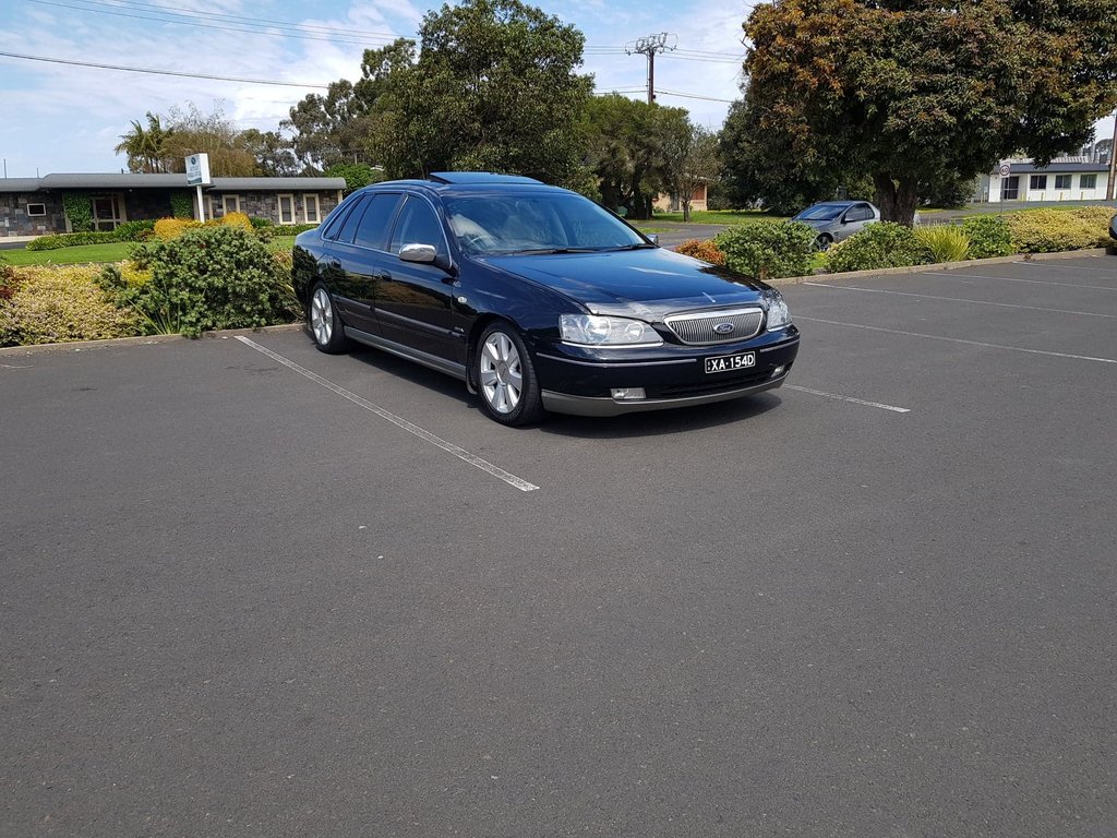

skotty Member 52 Member For: 10y 3m 5d Posted 26/05/21 08:35 AM Author Share Posted 26/05/21 08:35 AM (edited) On 02/05/2021 at 5:51 PM, k31th said: if you've still got access to those pictures you posted in the OP, I can fix those for you, if you'd like. I have the pics but unsure which ones were used. Anyways, g6e 19s are on and instantly happy again with with car works on them.. the anniversary 19s, silhouette paint, china beige interior, sunroof all pull together to make a sweet package. Then add in some boost! Anyway I need to pull my figure out I've got 3 weeks off work coming up and got a planned 3000km roadtrip I wanna do, and I'd rather take take fairlane over the VF Calais to be honest. Plus this car was built to be enjoyed. Just need to find some decent lock nuts, and the correct centrecaps. Oh and wash the damn thing. Are there many blokes on here from SA go roll racing? Edited 26/05/21 08:42 AM by skotty Link to comment Share on other sites More sharing options...
