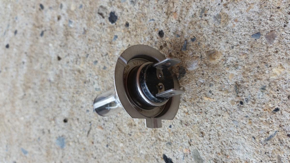

FGMKII Member 193 Member For: 10y 3m 14d Gender: Male Location: Western Sydney Posted 17/09/15 03:17 AM Author Share Posted 17/09/15 03:17 AM (edited) Girly hands help yeah. I was looking for a spring clip but didnt find any. The globes seem to just twist out.... I was sold H4 globes for the FG but now I have one out, they sre cometely different. Here is what I took out. It is just a single filament, not a high low like H4. Edited 17/09/15 03:17 AM by FGMKII Link to comment Share on other sites More sharing options...

k31th less WHY; more WOT Site Developer 28,303 Member For: 16y 15d Gender: Male Location: Melbourne Posted 23/06/19 04:03 AM Share Posted 23/06/19 04:03 AM it's H4 in the FG1 and FG2 it's H7 whatever car you have, it'll be the manual . if the headlight fixture/assembly has been changed from the factory, you'll be able to tell in the process of buying a new one. The process to be 100% sure which bulb it is, is to pull the one you're replacing out, take it to a shop, compare with the ones on the shelves with the one you removed and then buy whichever one it is. Link to comment Share on other sites More sharing options...
