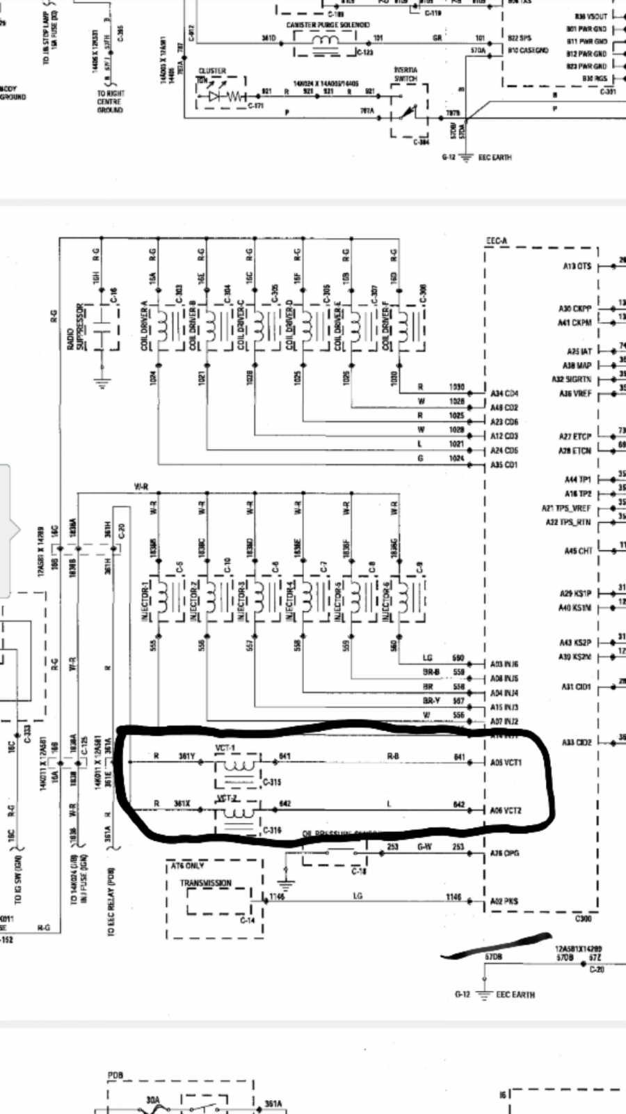

HI PSI Member 1,572 Member For: 17y 10m 30d Gender: Male Location: Central Queensland Posted 22/11/15 12:21 PM Author Share Posted 22/11/15 12:21 PM I have made some small adjustments to the ignition system for the Haltech. I was just going to purchase the igniter system and run the standard coils. I have now opted for the Haltech - HT-020207 Power Select 6 CDI - Dual Power Output 115mJ/150mJ x1 Given this, I have now gone to the Haltech HT-020132 High Output CDI Coil packs. I cannot begin to describe how tired I am of spending money on the car, and I really don't want to spend any more. But, this late in the build,and given the amount spent already, I cannot bring myself to skimp on the few last components. With this in mind, I'm going to delay the EGT's and associated modules, until I get some certainlty with upcoming work. We begin the installation of the Elite on the 1st and I hope to get some progress pics as it is being installed. At this time, we have decided to retain the standard engine harness and use a deutsch plug to manage the connections. We believe that we do not any additional wires in the BA harness to correctly run the both cam VCT's actively. I would greatly appreciate it if someone could confirm this for me. 1 Link to comment Share on other sites More sharing options...
Ralph Wiggum Moar Powar Babeh Lifetime Members 19,323 Member For: 18y 7m Gender: Male Location: Perth Posted 22/11/15 09:08 PM Share Posted 22/11/15 09:08 PM You are correct about the vct wiring. The control (earth) side of each vct solenoid goes back to the exchange connector separately. The physical hardware for independent vct existed on a BA but not the programming. 1 Link to comment Share on other sites More sharing options...
