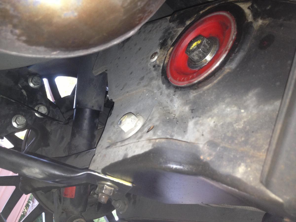

Ralph Wiggum Moar Powar Babeh Lifetime Members 19,323 Member For: 18y 6m 28d Gender: Male Location: Perth Posted 03/09/13 11:48 PM Share Posted 03/09/13 11:48 PM If they replaced all three diff mounting bushes and didn't set the depth correctly on the front bushes,the diff mounting out diggers can contact the cradle and cause symptoms similar to what you describe. Link to comment Share on other sites More sharing options...
mick1378 Member 14 Member For: 13y 1m 24d Gender: Male Posted 04/09/13 02:36 AM Author Share Posted 04/09/13 02:36 AM Thanks Ralph I will check it out. is there an measurement or something that I can check myself.I am assuming that you ment out riggers and they would be the 2 round rods that go from cradle forwards 2 body one either side of diff centre off memory. I'd found out after the fact that this is the first set of non genuine bushes they had installed. (Lucky me) Link to comment Share on other sites More sharing options...
Ralph Wiggum Moar Powar Babeh Lifetime Members 19,323 Member For: 18y 6m 28d Gender: Male Location: Perth Posted 04/09/13 02:37 AM Share Posted 04/09/13 02:37 AM Yeah thats correct mate, nothing you can really meausre in situ, just have a look how close the outriggers are to the cradle. (take a happy snap if you can and post it up) Link to comment Share on other sites More sharing options...
mick1378 Member 14 Member For: 13y 1m 24d Gender: Male Posted 04/09/13 03:30 AM Author Share Posted 04/09/13 03:30 AM Will do, I'm guessing touching or anywhere near touching is too close. Link to comment Share on other sites More sharing options...
mick1378 Member 14 Member For: 13y 1m 24d Gender: Male Posted 04/09/13 07:19 AM Author Share Posted 04/09/13 07:19 AM New at this so hope they upload. Now what I thought was ment by outrigger was the arm from the cradle to chassis but now I realise that you more than likley mean the two arms off the diff centre that attach to the left and right bush correct. Link to comment Share on other sites More sharing options...
Ralph Wiggum Moar Powar Babeh Lifetime Members 19,323 Member For: 18y 6m 28d Gender: Male Location: Perth Posted 04/09/13 07:42 AM Share Posted 04/09/13 07:42 AM Whats the part number on the bush? If I didn't know better I would swear they have been installed facing the wrong way. The arms look mighty close to me.EDIT: found the install instruction, The bush is installed with the recess to the rear, which is odd as it pulls the diff closer to the front Link to comment Share on other sites More sharing options...
