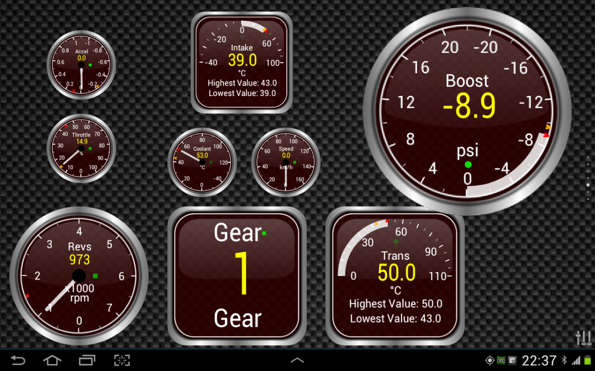

Bulletime Donating Members 937 Member For: 13y 3m 11d Gender: Male Posted 27/01/13 01:44 AM Share Posted 27/01/13 01:44 AM Mate if you could dig into the settings and look for the codes for trans temp that would be hugely appreciated... I've hunted around and cant find anything :'( Link to comment Share on other sites More sharing options...
bjc Donating Members 2,812 Member For: 20y 7m 16d Gender: Male Location: Townsville Posted 27/01/13 06:20 AM Share Posted 27/01/13 06:20 AM From the main screen get the settings tab up (bottom left button on phone), Press the Settings Tab, Manage Extra PIDs/Sensors (bottom left button again), Add predefined set and select Ford or Other (cant remember)...Mine was in this area and I cant remember how I got it there but the above info should help a little! Link to comment Share on other sites More sharing options...
bjc Donating Members 2,812 Member For: 20y 7m 16d Gender: Male Location: Townsville Posted 27/01/13 06:28 AM Share Posted 27/01/13 06:28 AM PID- 0105Unit Celcius- Min 0.0, Max 200.0Equation- A-40Scale Factor- x1Unit Type- C (put the degree symbal before the C)OBD Header- TCMMy car is a 09 F6X (turbo territory) though with the 6 speed auto so may or may not be the same and it may or may not screw your car up... Link to comment Share on other sites More sharing options...

Bulletime Donating Members 937 Member For: 13y 3m 11d Gender: Male Posted 04/02/13 11:13 AM Share Posted 04/02/13 11:13 AM Not necessarily, I can't seem to get trans temp on mine :@ Link to comment Share on other sites More sharing options...
