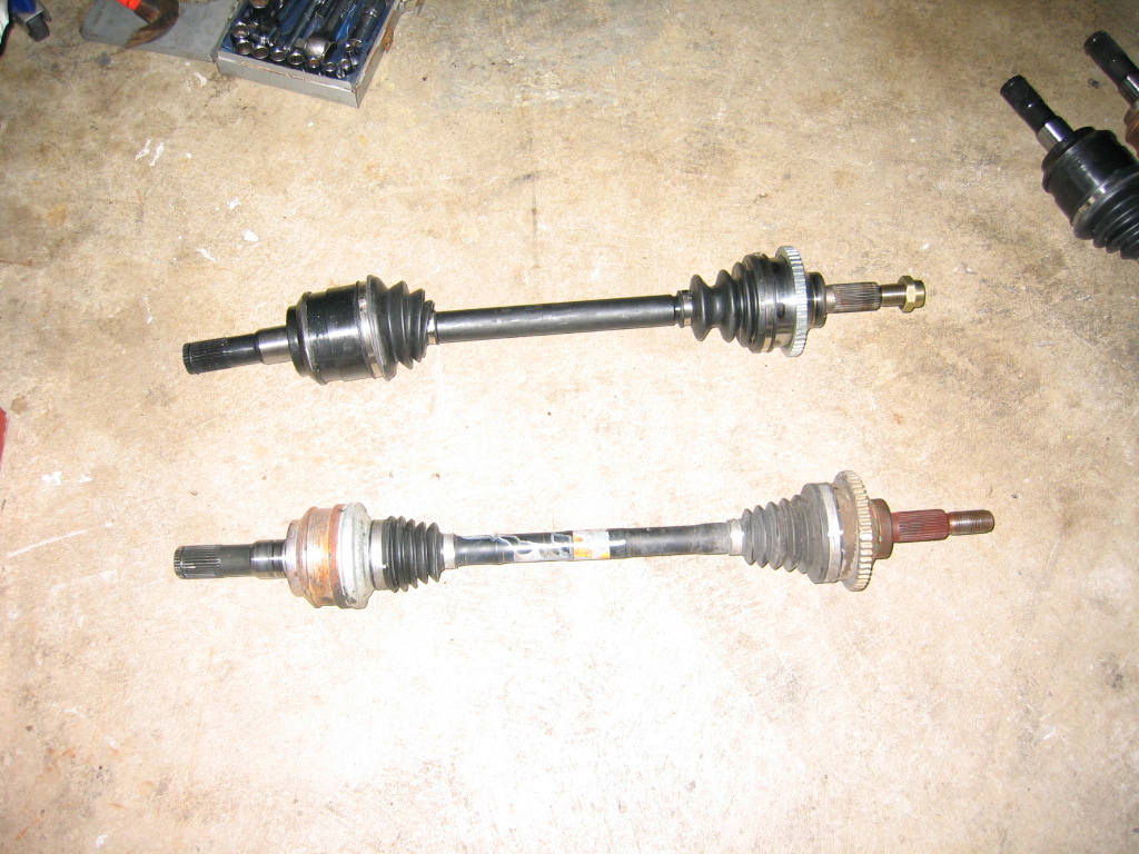

stealthxr Donating Members 553 Member For: 18y 2m 11d Gender: Male Location: The Shire Sydney AUS Posted 02/12/07 02:50 AM Share Posted 02/12/07 02:50 AM Thanks for the above Info 86gav Well I busted my Right CV last Thursday, so I had to replace that. remembered this thread and started making some inquiry's with CBC Bearings, No luck I called every outlet in Sydney and they had no stock, but they could get them in and that they will take about a week to arrive, I almost bit the bullet and then stumbled on THIS in CBC's website, called these guys up and they had them on the shelf , about $600 dollars and a day later (called on Friday received Monday) I received my 2 new half axles for less than the price of 1 POS ford OEM crap axle.IMO the axles supplied by AADI a far superior in build quality than the ford OEM 1's, and the actual shaft is about 2-3 mm thicker, according to my dodgy vernier calipers and the knuckles look bigger too, Now just have put the damm thing back together again and see how they hold up.. PS, to remove the shafts you dont have to remove the diff craddle, I just done because I noticed my diff bush was rooted so Im gonna replace that as well and YES it is easier than it looks PeteJust an update on these shafts, I have had No issues with these CV's what so ever, They have reduced my driveline shunt, that's probably cause my old ones were rooted !They went perfectly and general feel in the arse end is heaps better, I have a LOT more confidence in these shafts than I did in my standard ones , to anyone thinking of replacing their shafts look no further than AADI , good quality for a reasonable price!pete Link to comment Share on other sites More sharing options...
senna_T Forged Member Lifetime Members 15,818 Member For: 17y 2m 10d Gender: Male Location: SW Sydney Posted 02/12/07 03:12 AM Share Posted 02/12/07 03:12 AM looks the business pete, I reckon UNV3ME will be interested in these! Link to comment Share on other sites More sharing options...
