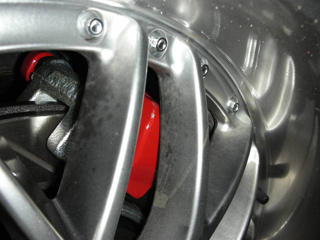

Ninka Donating Members 1,850 Member For: 22y 4m 20d Gender: Male Location: Perth, WA Posted 21/07/07 01:03 PM Author Share Posted 21/07/07 01:03 PM Haven't got the 5000's yet, they were delayed Finished fitting the BF rears today And YES that are VERY close to the inside of the rim, but JUST clears it Photos: Link to comment https://www.fordxr6turbo.com/forum/topic/36619-new-brakes/page/3/#findComment-557254 Share on other sites More sharing options...

Ninka Donating Members 1,850 Member For: 22y 4m 20d Gender: Male Location: Perth, WA Posted 21/07/07 11:29 PM Author Share Posted 21/07/07 11:29 PM It's a BA XR6 TurboThe backing plates are there, but as they are smaller than the disc, you cannot see them. Edge bevelling had to be trimmed slightly to fit the caliper.Pedal feel is unchanged (as you would expect)Braking is better, with a more confident feel Link to comment https://www.fordxr6turbo.com/forum/topic/36619-new-brakes/page/3/#findComment-557316 Share on other sites More sharing options...

ROLMDL role model Member 1,111 Member For: 19y 2m 3d Gender: Male Location: Melbourne,S.E Posted 22/07/07 07:31 AM Share Posted 22/07/07 07:31 AM (edited) we had the same BF rear caliper and the brake person who fitted it say its just touches so I had to keep the same BA rear calipers but painted =[ Edited 22/07/07 07:31 AM by Black ThundeR Link to comment https://www.fordxr6turbo.com/forum/topic/36619-new-brakes/page/3/#findComment-557434 Share on other sites More sharing options...
Ninka Donating Members 1,850 Member For: 22y 4m 20d Gender: Male Location: Perth, WA Posted 22/07/07 08:12 AM Author Share Posted 22/07/07 08:12 AM we had the same BF rear caliper and the brake person who fitted it say its just touches so I had to keep the same BA rear calipers but painted =[I think we run the same rims, so either the brake guy didn't check it properly, or there are subtle differences on the rims, as it definitely doesn't touch, though it is very close Link to comment https://www.fordxr6turbo.com/forum/topic/36619-new-brakes/page/3/#findComment-557450 Share on other sites More sharing options...
